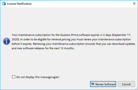

How to renew license for Quartus Lite v19.1?

Welcome to INTEL forum. From my understanding, the Quartus Lite Edition software requires no license, so it will continue working even after maintenance subscription expires. This is the normal behavior of the Lite Edition software and you can ignore the message. Please continue with the compilations and report to us back if the compilation is not successful with error message in Quartus.

The day after the Quartus Lite v19.1 license expired, Quartus will not proceed beyond the splash screen. No licensing dialogs, no errors, nothing, the app is simply frozen. By the way, I haven't made any recent changes to my PC, so I am sure this is related to the license "expiring".

I have the same problem. I noticed it because I can not generate *.sof file.
Also several sub-menus in Processing tab (and other tabs) are greyed out.
