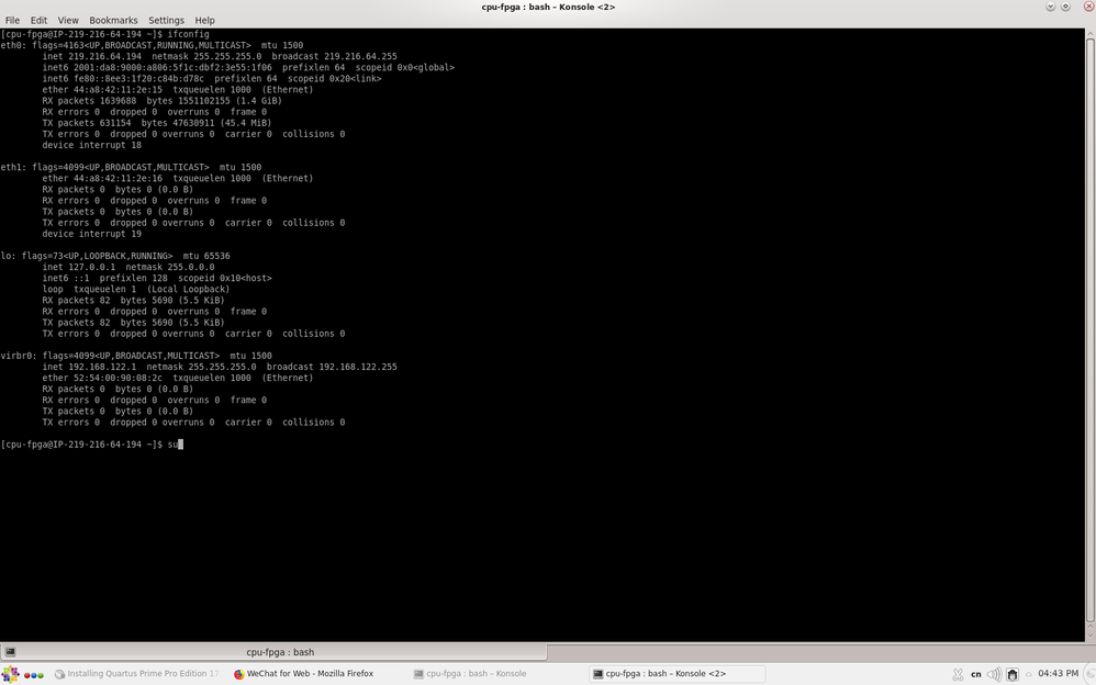

Such as create a dummy eth0.

My license was generated two months ago.And the Quartus Prime Pro can find it correctly.But the AOC compiler could not.
I'm sure that the AOCL and Quartus Prime Pro were downloaded from the Intel official website.
When I compiled the xx.cl with aoc .The error occured :
" Could not acquire a valid license for the Intel(R) FPGA SDK for OpenCL(TM).
Error: Verilog generator FAILED! "
I have read many answers on this community but none of them can solve my problem.I think I need more license to use aoc.
I want to know if I need an another license except the Quartus Prime Pro license?Such as IP license.

From the environment variable, I saw this:
export LM_LICENSE_FILE=/root/intelFPGA_pro/16.1/hld/license.dat
export ALTERAD_LICENSE_FILE=/root/intelFPGA_pro/16.1/hld/license.dat
The license file used seems like export from the same place.

Upon checking on the license file, I found that the license file does not included OpenCL software feature. You may need to apply free license for OpenCL software under University Program in the link below:
http://www.altera.com/education/univ/unv-index.html.
