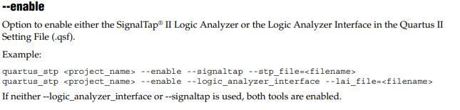

If case anyone looking for an answer, you can refer to Quartus Scripting Reference Manual
https://www.intel.com/content/dam/www/programmable/us/en/pdfs/literature/manual/tclscriptrefmnl.pdf
