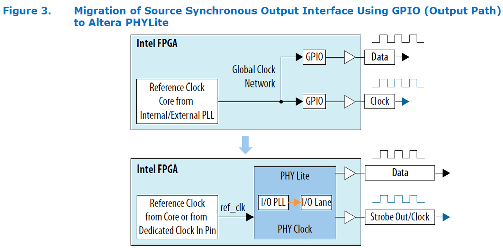

I am following AN756 to try to implement a source-synchronous output interface (Arria 10, Quartus 21.3 Pro):
The lower block shows "Reference Clock from Core or from Dedicated Clock In Pin". However, a "core" (PLL-generated) clock failed to build... and eventually I found this explanation:

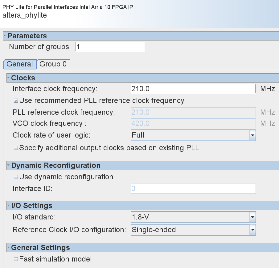

However, when I add the commands to that file, nothing seems to change. I have tried putting the commands in different places in the quartus2.ini file, changing to uppercase, changing whitespace, rebooting my PC, but nothing seems to work. I don't see any new option appear in Platform Designer:
