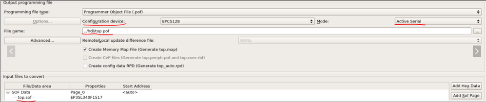

How to convert sof file to pof file by using tcl command?
Unfortunately, I need to frequently convert sof file to pof file.
It's time consuming if I manually do it.
How to convert follows picture to TCL command?
Could someone please tell me some information?
I can't find any command to do it.
Thank you very much.

You can use the quartus_cpf command to convert the programming file. You can refer to page 2-16 of the documentation https://www.altera.com/content/dam/altera-www/global/en_US/pdfs/literature/manual/tclscriptrefmnl.pdf for more detailed usage information and example. Please ensure to use latest quartus version or version 17.1 and above.

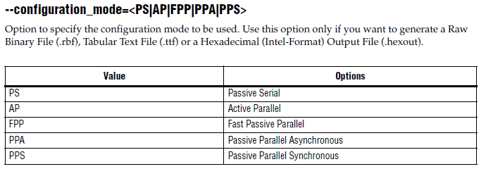

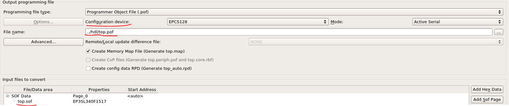

And how to config the mode? I use the Active Serial mode.
But I can't find it in the follow picture.
- NurAiman_M_Intel
What do you mean by config the mode? Do you mean Active serial code?
Active serial is AS.

Yes. As the follows picture, I use Active serial mode.
From the quartus --qhelp, Active serial mode is ASx1 as the follows picture, right?
- NurAiman_M_Intel
