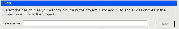

How to do that?
I had tried to key the command as follows picture into a TCL file. And I really add the TCL file into the Quartus project.
However, it don't work.
Can anyone help me? Thank you very much.
By the way, I add TCL file into the Quartus project by using GUI.
Command in the TCL file:
The files you add there are design files.
To do this, just manually edit the .qsf or add a "source" command in the .qsf to source your separate .tcl file.

thank you, sstrell, very much. Can I use the Quartus GUI to add a "source" command in the .qsf to source my separate .tcl files or .qip files?
Or just only can manually add a "source" command in the .qsf file?
- sstrell
No, you have to manually edit the .qsf. There's no option for this in the GUI.
