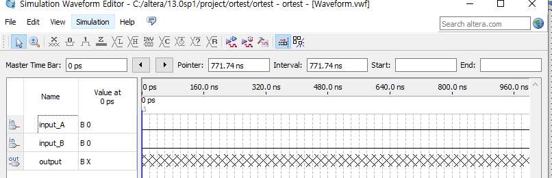

Hi, I used to simulate the simple schematic. The compile worked fine.
But when I ran University program/vwf, There was an error Warning: (vlib-34) Library already exists at "work".
I tried to reinstall it. but wasn't work.
What can I do?

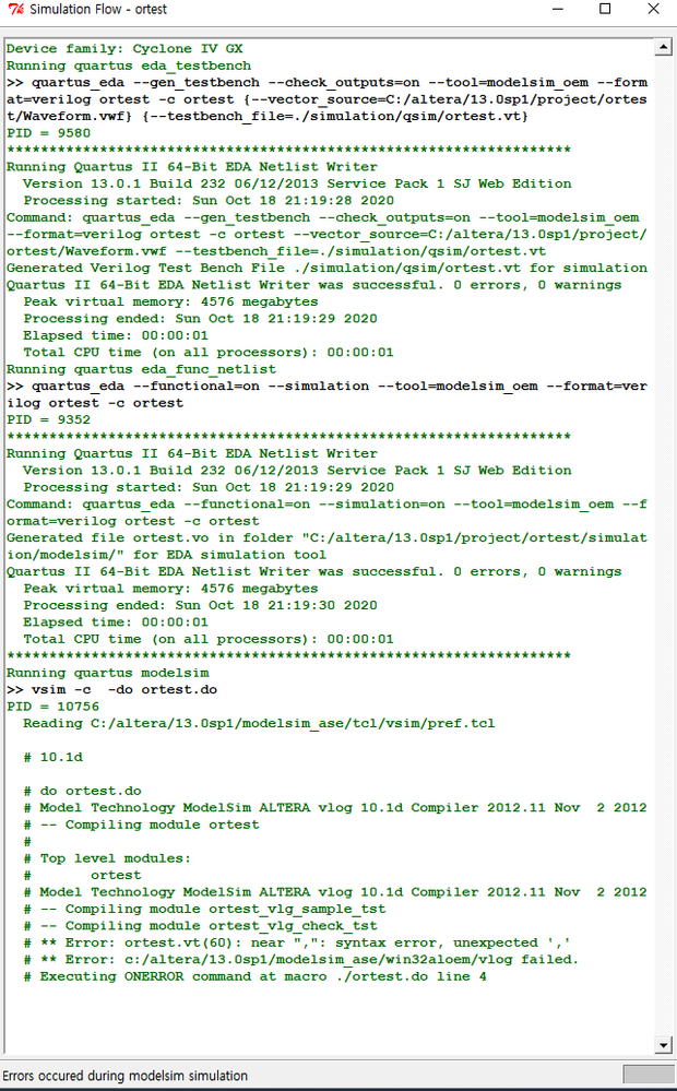

specialization :
Device family: Cyclone IV GX
Running quartus eda_testbench
>> quartus_eda --gen_testbench --check_outputs=on --tool=modelsim_oem --format=verilog test1 -c test1 {--vector_source=C:/altera/13.0sp1/quartus/bin64/project/test1/Waveform1.vwf} {--testbench_file=./simulation/qsim/test1.vt}
PID = 1364
Running Quartus II 64-Bit EDA Netlist Writer
Version 13.0.1 Build 232 06/12/2013 Service Pack 1 SJ Web Edition
Processing started: Mon Oct 12 19:35:29 2020
Command: quartus_eda --gen_testbench --check_outputs=on --tool=modelsim_oem --format=verilog test1 -c test1 --vector_source=C:/altera/13.0sp1/quartus/bin64/project/test1/Waveform1.vwf --testbench_file=./simulation/qsim/test1.vt
Generated Verilog Test Bench File ./simulation/qsim/test1.vt for simulation
Quartus II 64-Bit EDA Netlist Writer was successful. 0 errors, 0 warnings
Peak virtual memory: 4577 megabytes
Processing ended: Mon Oct 12 19:35:30 2020
Elapsed time: 00:00:01
Total CPU time (on all processors): 00:00:01
Running quartus eda_func_netlist
>> quartus_eda --functional=on --simulation --tool=modelsim_oem --format=verilog test1 -c test1
PID = 1128
Processing started: Mon Oct 12 19:35:30 2020
Command: quartus_eda --functional=on --simulation=on --tool=modelsim_oem --format=verilog test1 -c test1
Generated file test1.vo in folder "C:/altera/13.0sp1/quartus/bin64/project/test1/simulation/modelsim/" for EDA simulation tool
Processing ended: Mon Oct 12 19:35:31 2020
Running quartus modelsim
>> vsim -c -do test1.do
PID = 9324
Reading C:/altera/13.0sp1/modelsim_ase/tcl/vsim/pref.tcl
# 10.1d
# do test1.do
# ** Warning: (vlib-34) Library already exists at "work".
# Model Technology ModelSim ALTERA vlog 10.1d Compiler 2012.11 Nov 2 2012
# -- Compiling module test1
# Top level modules:
# test1
# -- Compiling module test1_vlg_sample_tst
# -- Compiling module test1_vlg_check_tst
# -- Compiling module test1_vlg_vec_tst
# test1_vlg_vec_tst
# vsim -L cycloneiv_ver -L altera_ver -L altera_mf_ver -L 220model_ver -L sgate -c -t 1ps -novopt work.test1_vlg_vec_tst

Hi, I don't think the warning message will impact the simulation but you should check for any error message that followed after that.
May I know what is not working in your project?
- agunh

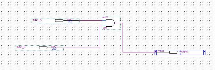

I ran a very simple OR schematic. Compilation was good. The above error occurred during the simulation process, but I do not know how to fix it.
- RichardT_altera
It seems that is an error.
Error: ortest.vt(60): near ",": syntax error, unexpected ','
Could you check the ortest.vt file line 60, is there something missing?
I am not sure if there could be a bug in previous Quartus version, could you try to install the latest Quartus version for Cyclone IV GX device and see if the issue persists? Lite version 19.1 or Standard version 20.1.
