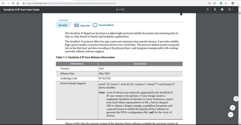

Can You check the device support for Serial II IP?
Choose the supported device from the below attached table & then try,

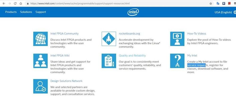

How do I file a "Service Request"?
- Vicky1
Please refer the below link,
https://www.intel.com/content/www/us/en/programmable/support/support-resources.html
Check the My Intel option from below screen shot.
