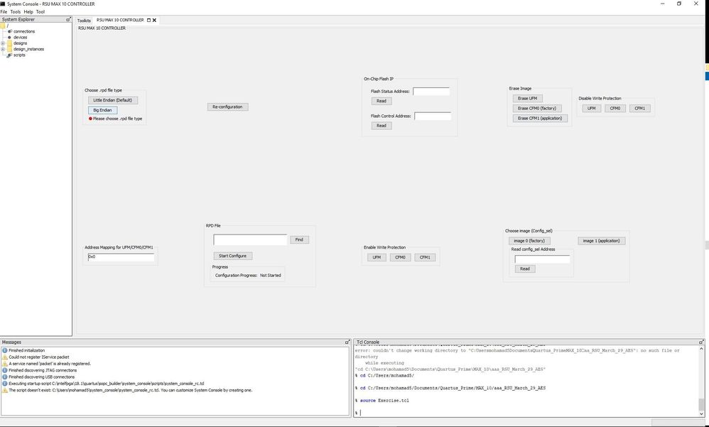

If you don't want to use NIOS II, you can also using tcl script via System Console to update your Remote Upgrade MAX 10.
Here is my TCL design example (i'm apologize for my messy tcl code 😂 😂 😂 ):
Refer to attachment for details.
