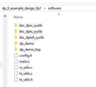

- BoonT_Intel
Hi Sir,
All these files fall under "software" folder after you generated the DisplayPort IP design example.

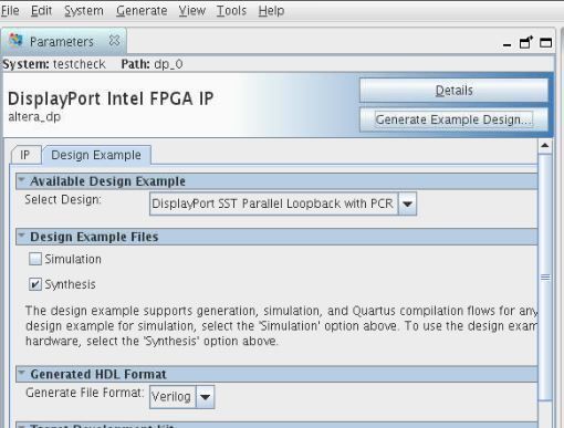

- BoonT_Intel
Open the DisplayPort IP GUI from the IP catalog, you will find the generate example design button on the top right corner.
