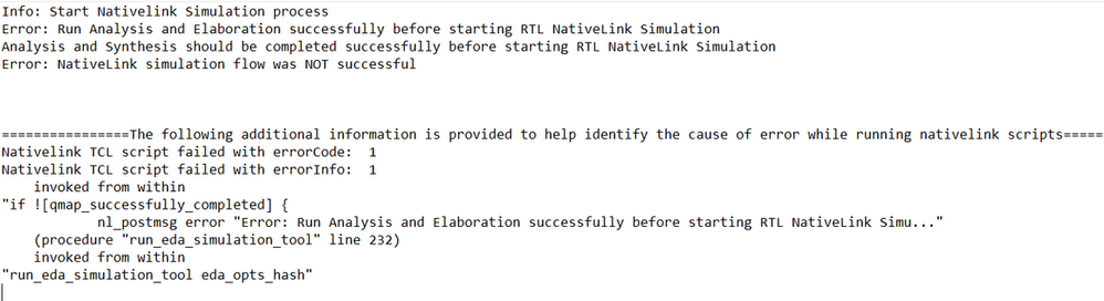

Help pls Nativelink TCL script failed with errorCode: 1
  • sstrell's avatar
    sstrell
    As it says, run Analysis & Elaboration or full synthesis from the Quartus Processing menu first.
