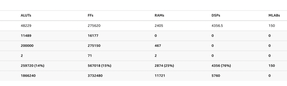

The complier give the following error message
Anyone can tell me how to analyze the error?
I can't figure out the reason of failure in routing from these message

In the report only DSP usage is above 25%, so the routing problem should due to DSP.
Does that mean we can never make full use of DSP?
What percentage of DSP is a reasonable design that can be routed?
Thank you very much
