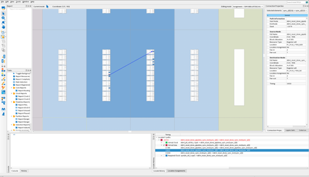

Is it possible to write net_delay SDC command in HDL as attribute?
