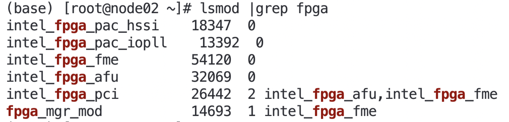

Found no active device installed on the host machine while installing the Intel Acceleration Stack
I encountered an error while trying to install the Intel Acceleration Stack Development Package on the Host Machine. When I finish the installation and use “aocl diagnose” to see the boards connected to the host machine, it shows that "No devices attached for package" and "Found no active device installed on the host machine".
So I contacted the dealer, they asked me to use two instructions which are "cat /sys/class/fpga/intel-fpga-dev.0/intel-fpga-port.0/afu_id" and "fpgainfo fme". But it shows "f7df405cbd7acf7222f144b0b93acd18" and "Board Management Controller, microcontroller FW version unavailable. Last Power Down Cause: unavailable. Last Reset Cause: unavailable (can't open)".
This problem has been bothering me for a long time, so the dealer advised me to post here for help.The type of the host machine is Intel Xeon CPU with FPGAs and the type of the device is Intel FPGA Programmable Acceleration Card D5005. I upload some screenshots of the problem to the attachment.
