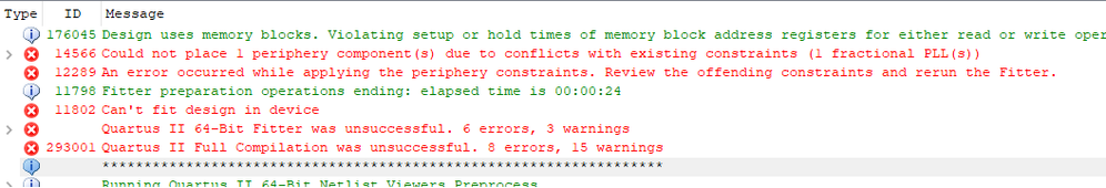

I got an error 14566 : Could not place 1 periphery component(s) due to conflicts with existing constraint (1 fractional PLL(s)).
How can i fix it?

Without knowing anything about the design or even the target device, it's not really possible to diagnose this. Can you provide more details or post the project?
You can also expand the error message to see exactly what the conflict is.

Excuse me, this is projet which got error above.
I got this error after i had assigned PINs to implement it on DE1_SoC_mtl2(CycloneV) Kit
Can you help me fix it, please?

Check clk_50 pin assignments.
Clock pin should be AF14/AA16/Y26/K14.
After changing the clock pin, I can run fitter successfully.
