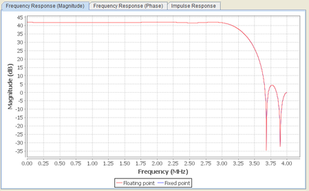

I'm designing a filter with the FIR II IP. Input data rate is 64 MHz and decimation factor is 8. I want the frequency response to be low pass cut off at 3.2 MHz.
The confusing thing is whether the ...
