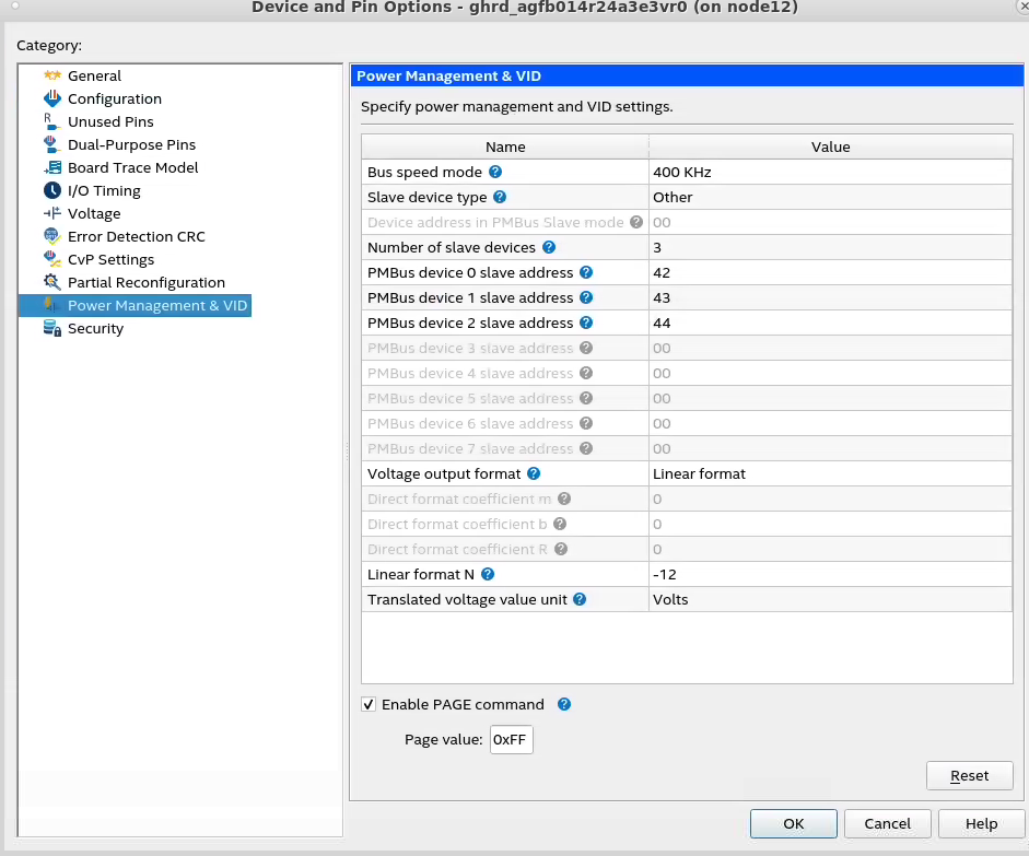

Apparently i need to change the VID setting but i don’t know what to do.
Thanks in advance for your help!

      Thank you for your reply,
      I verified the VID setting but it seems to be correct.
      This message appears also when i try to program the Agilex GHRD .sof file.
      Is there another way to correct this error?

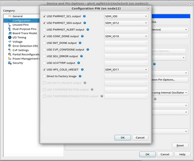

    Can you try the following VID setting for Agilex F-Series Development Kit?
    set_global_assignment -name VID_OPERATION_MODE "PMBUS MASTER"
    set_global_assignment -name USE_PWRMGT_SCL SDM_IO0
    set_global_assignment -name USE_PWRMGT_SDA SDM_IO12
    set_global_assignment -name USE_CONF_DONE SDM_IO16
    set_global_assignment -name PWRMGT_BUS_SPEED_MODE "400 KHZ"
    set_global_assignment -name PWRMGT_SLAVE_DEVICE_TYPE OTHER
    set_global_assignment -name PWRMGT_SLAVE_DEVICE0_ADDRESS 42
    set_global_assignment -name PWRMGT_SLAVE_DEVICE1_ADDRESS 43
    set_global_assignment -name PWRMGT_SLAVE_DEVICE2_ADDRESS 44
    set_global_assignment -name PWRMGT_SLAVE_DEVICE3_ADDRESS 00
    set_global_assignment -name PWRMGT_SLAVE_DEVICE4_ADDRESS 00
    set_global_assignment -name PWRMGT_SLAVE_DEVICE5_ADDRESS 00
    set_global_assignment -name PWRMGT_SLAVE_DEVICE6_ADDRESS 00
    set_global_assignment -name PWRMGT_SLAVE_DEVICE7_ADDRESS 00
    set_global_assignment -name PWRMGT_TRANSLATED_VOLTAGE_VALUE_UNIT VOLTS
    set_global_assignment -name PWRMGT_VOLTAGE_OUTPUT_FORMAT "AUTO DISCOVERY"
    set_global_assignment -name PWRMGT_PAGE_COMMAND_ENABLE ON

      Thank you for your suggestion, but i already have these settings for my project
