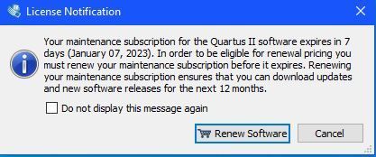

I am a maker hobbiest and I have completed projects on old Altera parts such as the Cyclone FPGA family and the MAX II CPLD family.
I compile RTL using Quartus II 64-Bit Version 13.0.1 Build 232 06/12/2013 Web Edition, because this "legacy" software supports the old Altera products which I use. Support for my preferred Altera parts has been DROPPED in later versions of Quartus.
SO before anyone suggests installing the latest and greatest version, this is NOT a solution.
When I launched Quartus today, I got the following alert box.

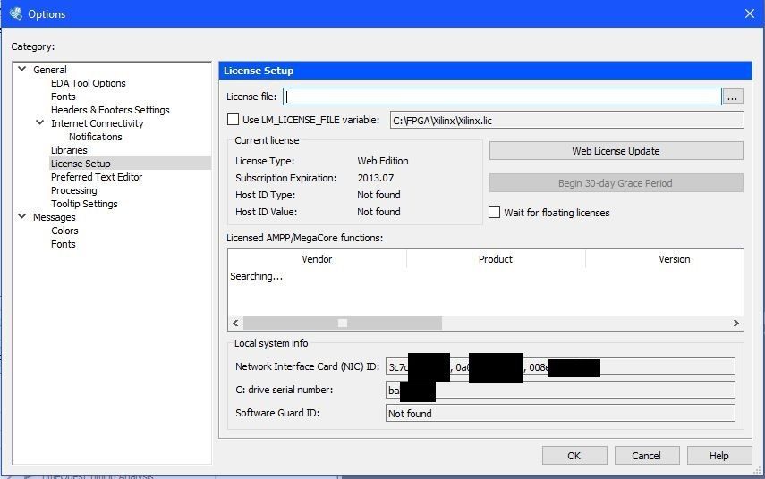

Now to be honest, I am unsure where Quartus is getting the current licence information from. It's certainly NOT the LM_LICENCE_FILE variable!
I wondered if the warning was simply nothing more than a warning (triggered by the end of year date), and I can continue to use this software version "as is" with no licence file?

  • Hello,
    From my understanding, the Quartus Lite/web Edition software requires no license, so it will continue working even after maintenance subscription expires. If there is a subscription error message appear. This is the normal behavior of the Lite/web Edition software and you can ignore the message. Please continue with the compilations and report to us back if the compilation is not successful with error message in Quartus.
    Hope this information is helpful.

    License files are version-agnostic. They are just for a yearly subscription.
    But the old web edition didn't require a license. Neither does the current Lite edition (basically the same as the web edition). If you click "Renew Software" or "Web License Update" what happens?

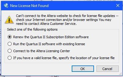

      "Renew Software" tries to bring up Internet Explorer, which now defaults to Microsoft Edge, which goes to a generic Intel FPGA web page => no help whatsoever.
      "Web Licence Update" brings up the following
      None of the options are helpful.
      Perhaps it simply is that the software does not need a licence for the web pack.
      FWIW, I did find an old license file from 2018, which was in FlexLM format. I have no re-collection when or how it was generated.
