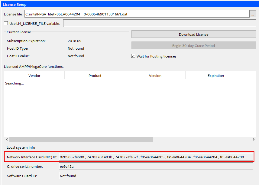

I need access to the configuration encryption options for Intel MAX10 FPGA in Quartus Lite 18.1 which requires a license per AN 556: Using the Design Security Features in Intel FPGAs
I registered for a license through the self-service license tool using one of the NIC ID's on my machine (there are several) and received a .dat license file via e-mail. The .dat license was added in Quartus License Setup but doesn't resolve issue, encryption options are not available in the Convert Programming Files utility.
Then noticed that NIC ID in the license setup window is a comma separated list of NIC ID's present on my machine (02xxxxxxxx80 , 74xxxxxxxx3b , 74xxxxxxxx7f , f8xxxxxxxx05 , faxxxxxxxx04 , f8xxxxxxxx04 , f8xxxxxxxx08). Does license need to include all NIC IDs?
I attempted to get a new license through self-service tool, but no products appear in page and The original NIC ID I had used is not recognized.

      From the Quartus Lite License screen: 0205857feb80 , 74782781483b , 747827efe67f , f85ea0644205 , fa5ea0644204 , f85ea0644204 , f85ea0644208

    Thanks for reply. We have open ticket requesting encryption license. I’ll be back with an update.
  • AR_A_Intel's avatar
    AR_A_Intel
    Hi
    The encryption License granted. Kindly generate a license file in Self Service Licensing Center
    Guidance: using Google Chrome, login to Self Service Licensing Center at https://fpgasupport.intel.com/Licensing/license/index.html --> select Computer and License Files --> Select a computer to generate a new license file.
