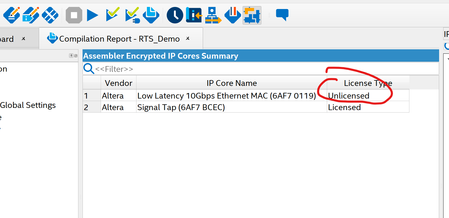

4 years agoDoes LL 10g eth Mac ip need a license?
I am using quartus prime pro 19.1 to design Cylone 10 gx. I try to use LL 10g eth Mac ip but at the end of compilation it pops out error message as below,
Error(204009): Can't generate netlis...
