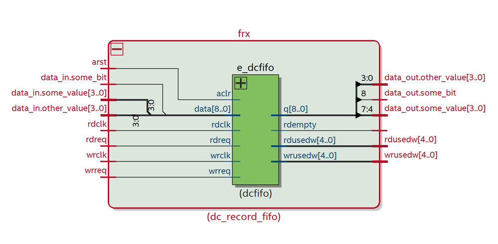

      Running the code in the src folder below (demo toplevel) in a Quartus Prime Pro 2020.1 does give the expected RTL-viewer output:
      This uses the Cyclone 10 GX as device family, as the Cyclone 10 LP is not supported.
