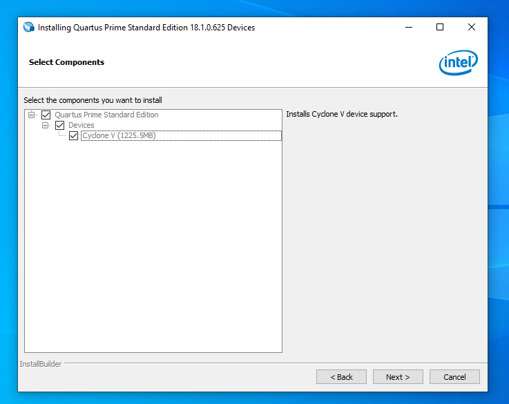

      Hello Nurina,
      I have installed the Cyclone V package (picture attached).
      Still there are no devices to choose from when opening a new project.

        I'd just try uninstalling and reinstalling. You might just have a bad installation. If you have the Cyclone V .qdz file in the same directory as the Quartus installer, you can install the software and devices at the same time, which should guarantee that it will work.

      I have re-installed and everything works just fine now.
      Thanks for the support,
