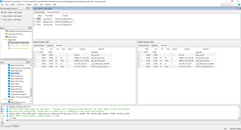

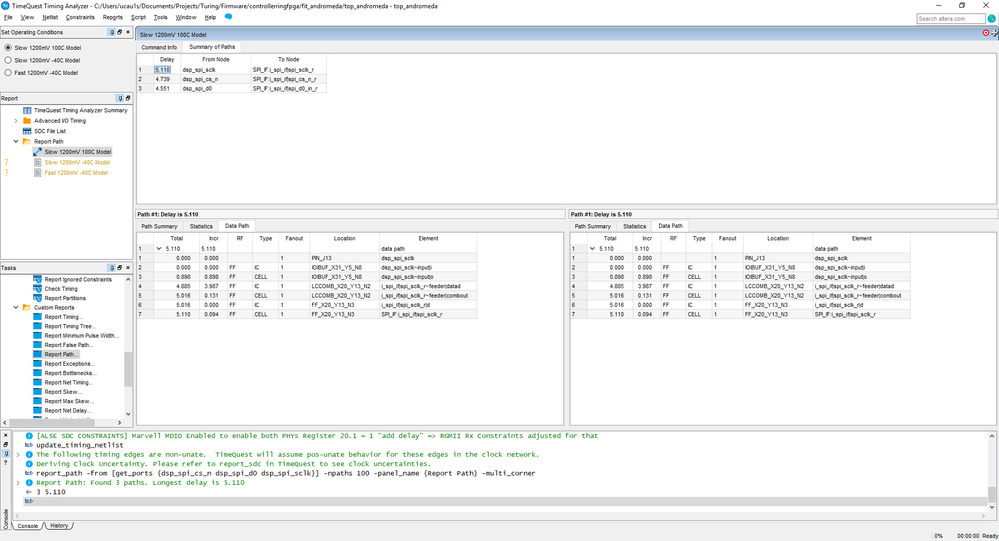

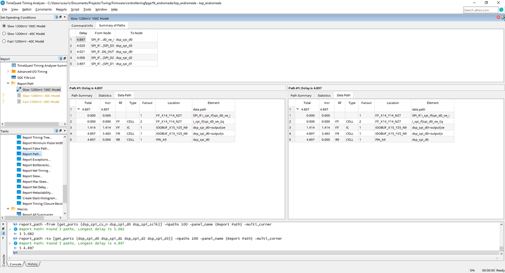

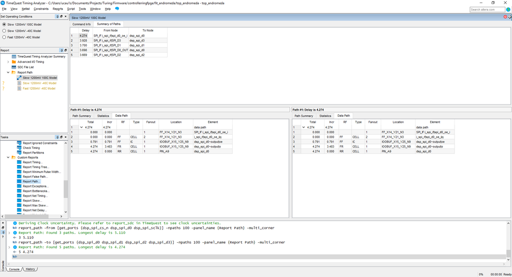

If I use TimeQuest and do a "Report Path" with -from and -to for all the SPI input and output ports at the toplevel, this is what I get:
For v15.1.0:
-from
-to
For v17.0.2:
-from
-to
From the timing reports of the paths, the slack seems like it's not too bad for the 10ns clock period. I don't quite get why even though the SET_FALSE_PATH for those ports listed above are in the sdc, I can still get the timing reports of the paths. I need to learn how to do timing constraints properly still. I'm guessing it's not constrained, but resulted in the numbers above? Those are only the paths -from or -to the toplevel ports and the SPI module pins I believe. I can't seem to get proper reports for the paths -from / -to the pins in the SPI module itself.
