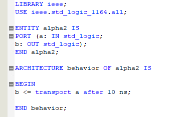

hi, I am trying to delay an input signal by a certain time delay as follow but the problem when i simulate the signal is always delayed by 7.946 ns even if I change the time delay in the code...

It should work fine, I have Checked it with modelsim. Also note that delay are not synthesizable.
Anand
