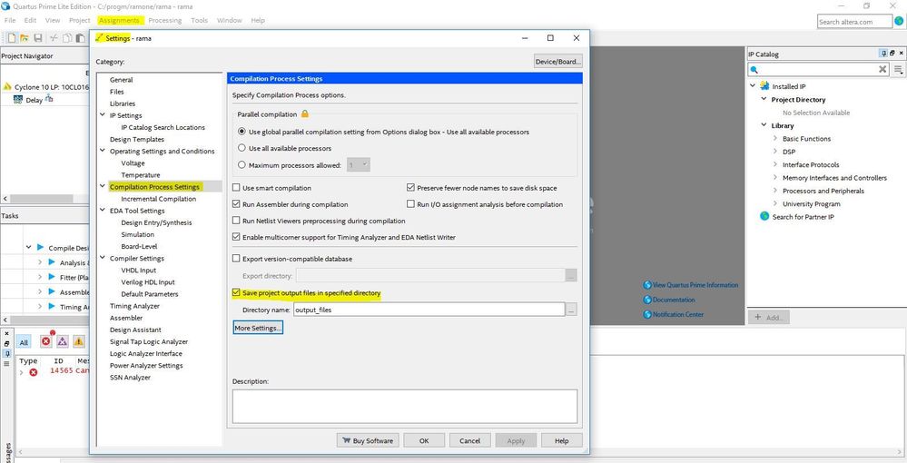

How can I define the default reports directory in Quartus-II?
Thank you!
By default, Intel Quartus software software saves all project output files in 'output_files' directory under Project directory & if you want to change the location click Assignments > Settings > Compilation Process Settings, and specify the Save project output files in specified directory option(Refer attachment).

Hi Vicky, Yes you can close this case, I selected your answer as the best, thanks!
