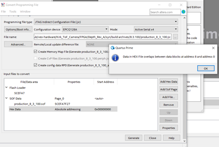

4 years agoData in HEX File overlaps between data blocks at address 8 and address 0
I am using Quartus Prime 17.0.2
When to generate a JIC file, I am able to add an SOF file with out issue, but I get an error when doing the same for HEX.
The existing forum posts on this ...
VCham
4 years agoThanks for the suggestion. It seems the issue has to do with the reset vectors.
My issue is that my current configuration is a bit unusual. We have implemented our EPCQ controller outside of Qsys/Platform Designer because the version of Quartus we are using (17.0.2) is incompatible with the EPCQ device we have. To solve this work around we implemented a v19 EPCQ controller in our top level design rather than inside Qsys. This works but presents an issue given the Embedded User Guide. Any thoughts on how to accommodate this?
