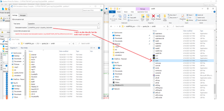

Dear Support,
I am learning how to use Quartus Pro, under tools-> launch simulation library compiler, I filled the executable location correctly. I confirmed that the vsim.exe is there. but the t...

Just to check with you, have you add /vsim.exe in "Executable Location"?
If no, kindly try to add /vsim.exe. If the issue still persist, kindly do let me know.

Hi Pavee,
That was my initial post asking for, when I put in the path of "Executable Location", the Quartus would not accept. I installed Questa, I can execute it with no problem. QuestaSim is the only option for Quaruts Pro. and the path is correct. but I don't understand why Quartus keep asking me to specify the simulation tool executable location. I guess I misunderstand some terminology. I hope I can get help in this forum.
Thank you for your reply, hope you can give me some suggestion to make this work.
