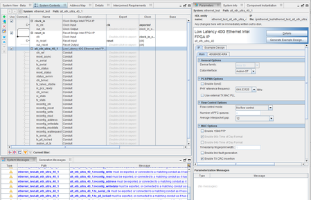

7 years agoConduit outputs only in IPCore 40G Ethernet
I'm trying to test "Low Latency 40G and 40GBASE-KR4 MAC & PHY" IPCore. Instantiation of a core in Platform designer shows an IP which have only "Conduit" type outputs. no clocks no buses, nothing. I...
SengKok_L_Intel
7 years agoHi,
Yes, I can observe the same. The IP is currently need to connect from the top level of the design. You may generate the example design to get more information of the connection.
