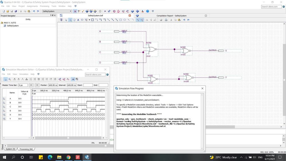

Can't launch the Modelsim-Altera Software
My OS is Windows 8 64 bit. I'm using Quartus II 13.1 Web Edition, and Modelsim 10.1d.
My path in EDA Tools is set to "C:\altera\13.1\modelsim_ase\win32aloem", when I go Tools > Run Similation Tool > RTL Simulation; I get this Nativelink Error:
Can't launch the ModelSim-Altera software -- the path to the location of the executables for the ModelSim-Altera software were not specified or the executables were not found at specified path...
I can manually start it by the way.
Thank you

    Okay, so far, in the Quartus window I'm selecting:
    Assignments > Settings
    Then in the pop-up window, the following category:
    EDA Tool Settings > Simulation
    Help, I don't see any place to insert a path to the simulator executable... The output directory is given though.
  • SSHRE2's avatar
    SSHRE2
    You are looking into wrong path.
    You should go to Tools> Options>EDA Tool Options
    And then insert the valid path.
