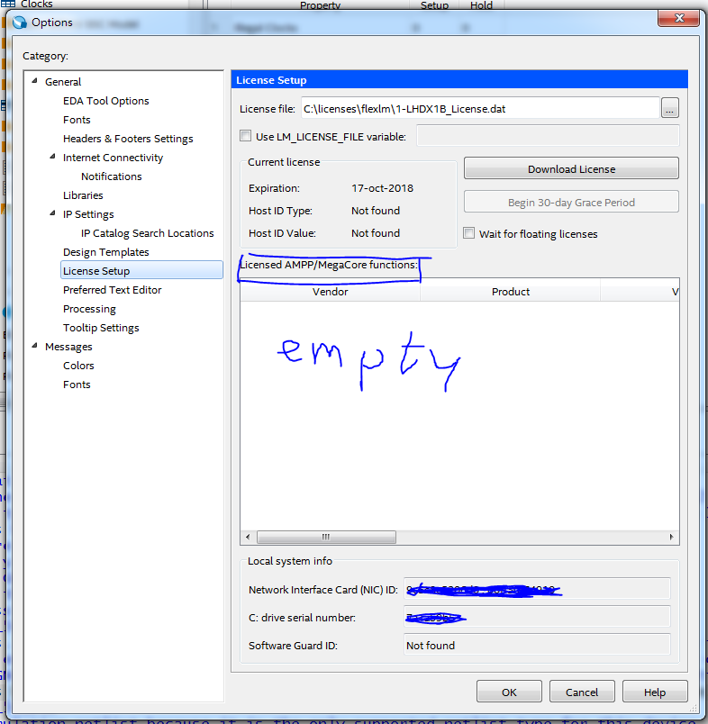

I have written a simple code for QDRII+ SRAM testing. However, when the compilation was passed (no error), the .sof wasn't generated because the using Quartus prime is in evaluation mode.
I have checked the license setup as the following figure.
Is there something wrong with my license?

Hi Chen,
Please provide following details,
- Quartus version & edition
- Used IPs/MegaCore Functions in design
- Log file(critical Warnings)

If you're using the Lite edition of Quartus, you still need additional licensing for the IP Base Suite, that includes the memory IP. The IP Base Suite is included in licensing for the Standard and Pro editions.

The problem is solved.
It's just my typo of MAC when applying the quartus license.
