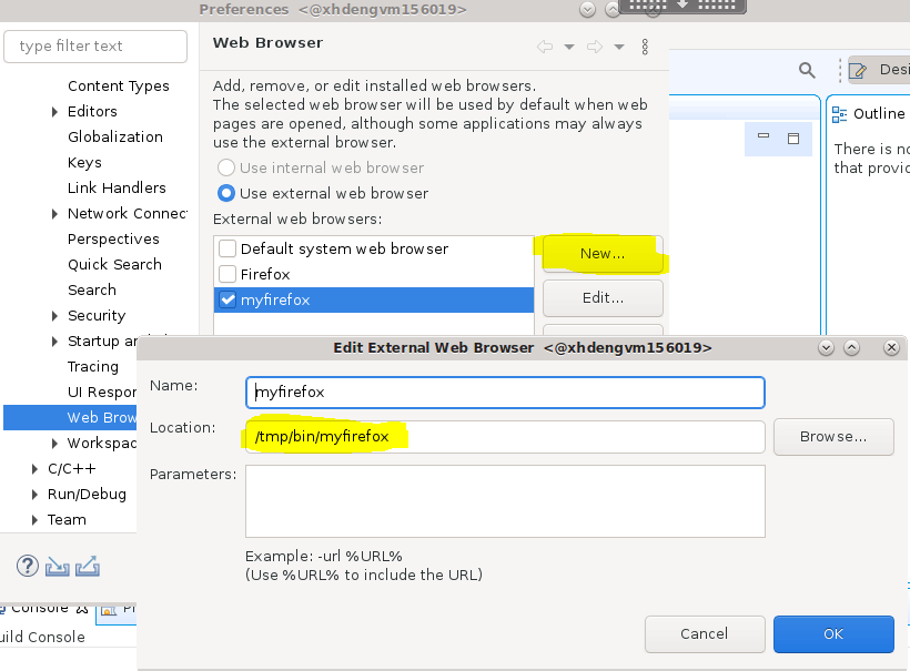

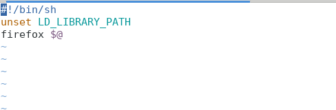

  • Hello,
    This issue occurs in the newer Firefox version (Mozilla Firefox 81.0).
    The supported Firefox version in Vitis IDE is Mozilla Firefox 78.4.1esr.
    The following work-arounds are available:
    • Roll back to the older Mozilla Firefox version - Users can install the previous Firefox version - Mozilla Firefox 78 to avoid this issue.
    • Custom Shell script - A custom shell script can be created with the below content
    regards,
    Farabi
