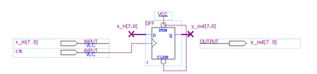

5 years agoBus index reversal when SystemVerilog module instantiates a BDF in Quartus Prime Pro 21.2
I have a legacy BDF that I need to use in a current design. Using Quartus Prime Pro v20.4 or v21.2, I see the bus indexes reversed on the port connections when the BDF diagram is instantiated from wi...

Yeah, I'd just convert to HDL and use that if you have more complex designs causing this issue. Just save yourself the time and effort trying to fix the schematics.

5 years agoThanks. We opted to create a Verilog wrapper that bit-reverses all inputs and outputs to the schematic module, which should get us by for now.
I appreciate all of your help. It would be great if Intel would acknowledge this is a bug in the software and maybe even fix it...
