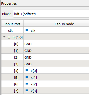

If I instantiate that in my Quartus Prime Pro 21.2 project instead of the .bdf, I get a correct instantiation:
If I instantiate that same .bdf rather than the generated verilog file in my v21.2 project, I get reversed connections. One gotcha I ran into was that regardless of the files listed in the project, the generated HDL file would get picked up for synthesis rather than the BDF if it was left in the project directory.
