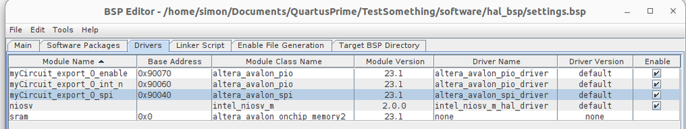

When I generate the BSP the, BSP editor shows three Modules, but not the driver defined in the myCircuit_sw.tcl
All three modules have some dependecy. Therefore I want to not only link them in HW, but also have a single SW driver, that handles the communication with the SPI and both PIOs.
