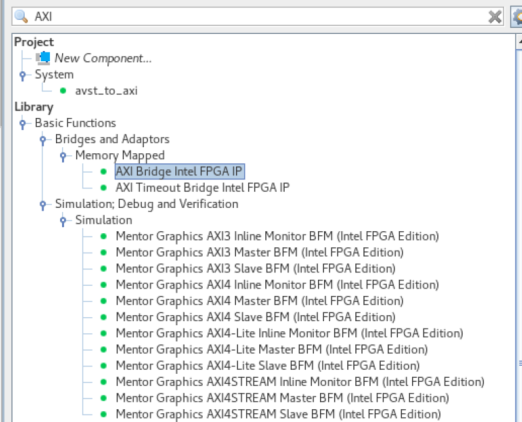

Is the function call Bursting Adaption that you pointed out is present as "AXI Bridge Intel FPGA IP" under Bridges and Adaptors section in Platform Designer ? Just wanted to confirm attaching the below snap.

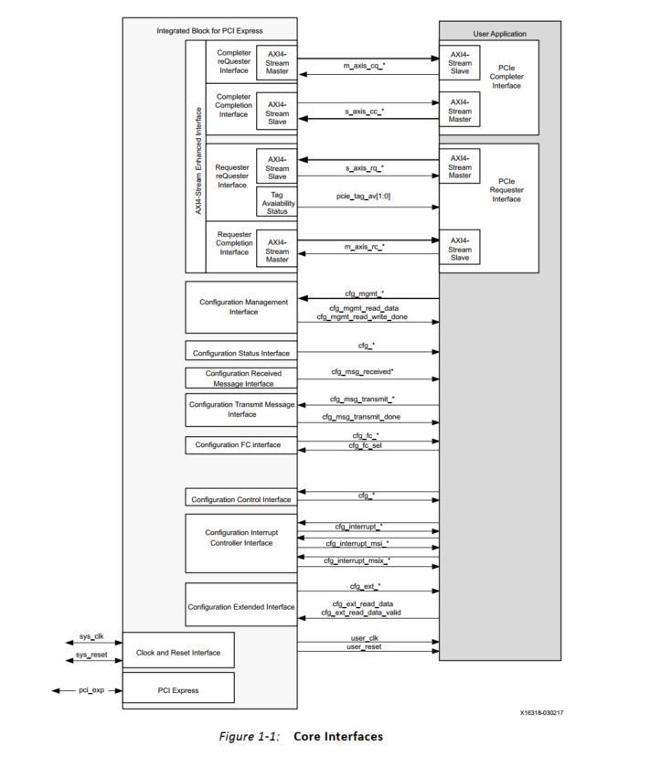

Below is the xilinx PCIe core interface snap which has the AXI4 ST interface with requestor and completion both. I need this type of PCIe core in our Altera Stratix10 FPGA. If that is not present I am trying to use avmm pcie bridge as endpoint + AXI bridge Intel IP with this I can reach till axi4. But my requirement is AXI4-ST, for that I initiated the request with IPS but they are not helping us.

- Is the function call Bursting Adaption that you pointed out is present as "AXI Bridge Intel FPGA IP" under Bridges and Adaptors section in Platform Designer? Just wanted to confirm attaching the below snap.
- My answer will be YES
