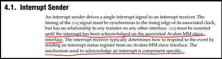

5 years agoAvalon MM Slave - How to detect Interrupt acknowledgement from HPS on CYCLONE V
Hi
We have a system design in platform designer for CYCLONE V. We have a custom IP module to which we have added an Interrupt Sender interface. The interrupt receiver is on the HPS instantiated in ...
EricMunYew_C_Intel
5 years agoAvalon master will disasserting the irq line as acknowledgement.
