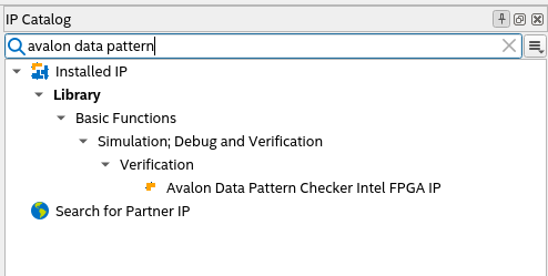

Avalon Data Pattern Checker IP, missing in Quartus Pro 22.1?
There is only the checker, not the generator:
Opening a project with such module, Quartus tells me the IP is missing.

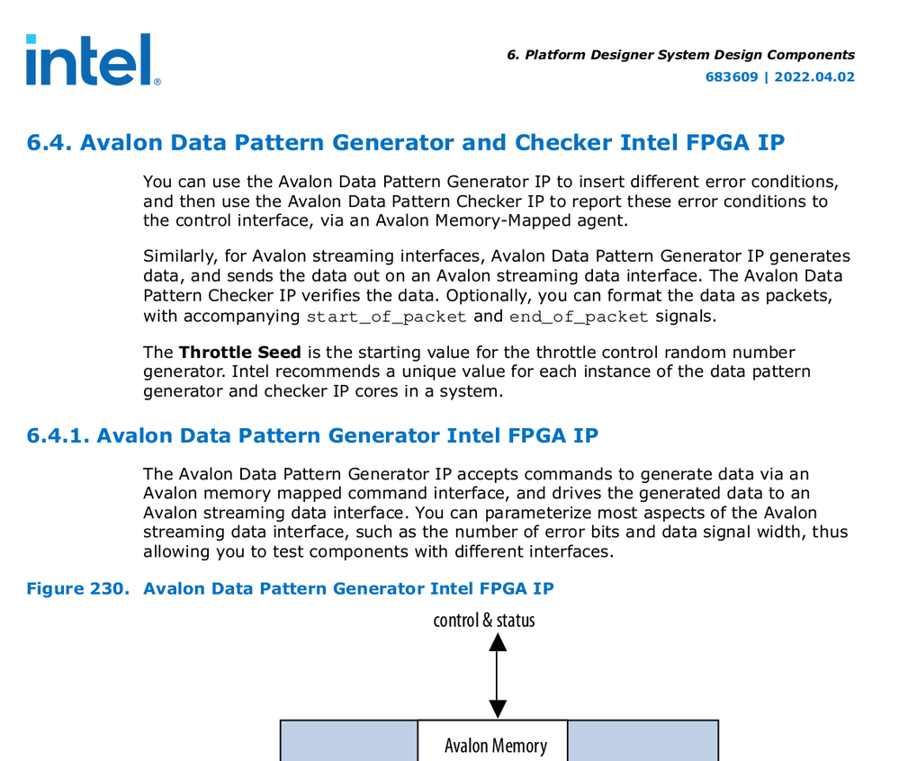

It's present in the user guide 22.1:
