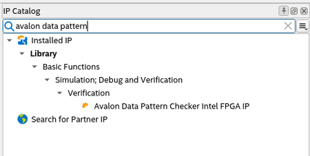

alexislmsContributor4 years agoAvalon Data Pattern Checker IP, missing in Quartus Pro 22.1? There is only the checker, not the generator: Opening a project with such module, Quartus tells me the IP is missing. It's present in the user guide 22.1: Show More
aikeuRegular Contributor4 years agoHi alexislms,I suggest that you can use back the older quartus version which has the IP for now.The fix will take some time to follow up.I will close this thread first if no further question.Thanks.Regards,Aik Eu
