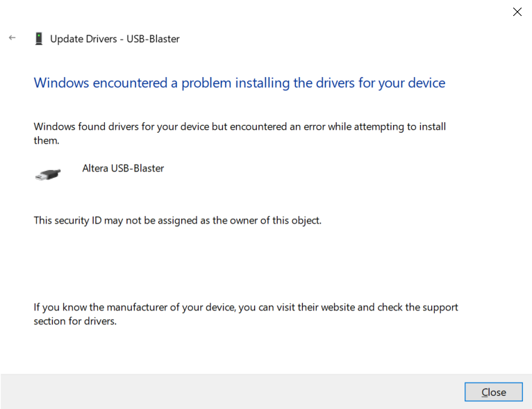

I am using Quartus Prime Programmer, and in the section that is supposed to detect hardware, my USB-Blaster was not registering. I then went to install the drivers for this device but found that it was not able to install it.
I searched the web and found some people were having issues due to the 'hashing issues' but my error message is much different.
I am giving device manager update driver the path: 'C:\intelFPGA_pro\21.2\quartus\drivers\usb-blaster' and getting the following error message.

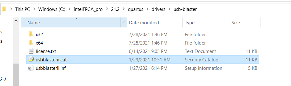

I tried using the KDB workaround by replacing the usbblaster.cat with the usbblasterii.cat because 'the driver is also applicable for the USB Blaster' and things got worse. Below is an image of it now not even finding the correct driver. I am not sure I understand how the driver could be applicable if it is not not even finding it? Are there any other work arounds because it seems like the KDB workaround did not fix anything.
