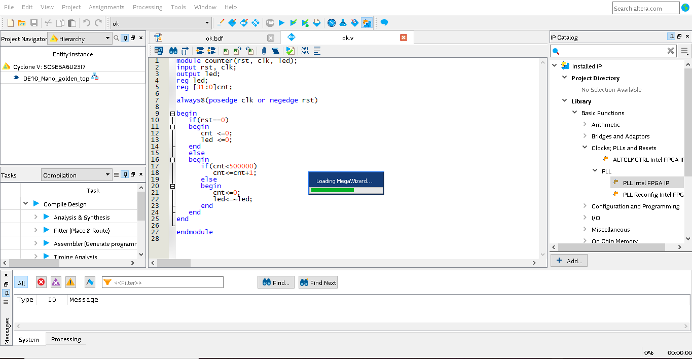

I'm getting a problem with Altera PLL/PLL Intel FPGA IP, everytime I try open it, it just loads forever with the message "Loading Megawizard".
I have tested with other Quartus' versions(16.1, 17.0, 18.1 and 20.1) and everytime I got this problem, I'm using windows 10, if I try to open the option of "reconfig", just below, it opens normally.
I'm pretty new to Quartus so I don't know, do I need to configurate for every application or is there another way of configuring if not just simply a solution to properly open the function.
