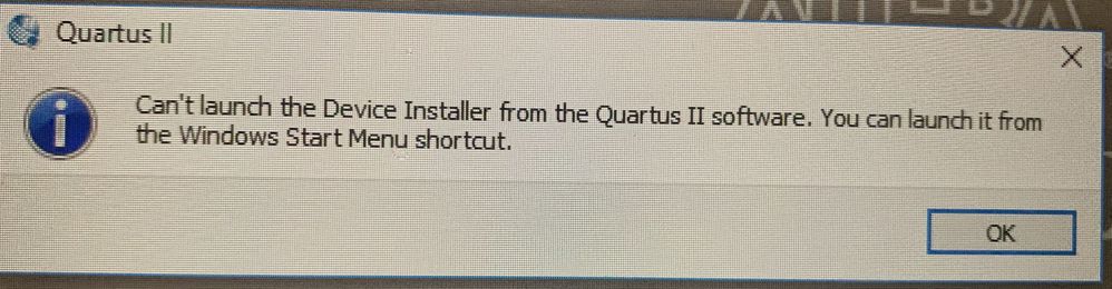

You did try to launch the one that comes with Quartus II . what the message says is you have to use the Standalone device installer.. This will be present in the Windows start menu under Quartus -> Device Installer. Use this version of the device installer to add the device support.

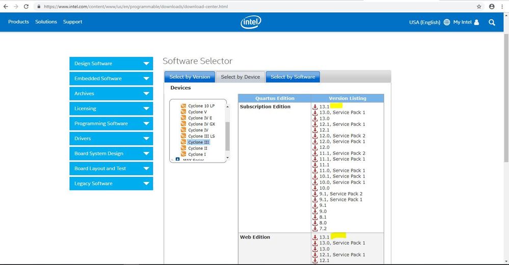

Download the device Cyclone III(specific Subscription/ Web Edition) from Download center and then open Device Installer(Quartus 13.1) windows start menu or
Quartus "Tools" option(If available) to install the device.
Refer the below link & screenshot,
https://www.intel.com/content/www/us/en/programmable/downloads/download-center.html
please let me know if this has helped

Thanks Vikas for the update. I have followed above listed steps. However, whenever I am trying to install device under the tools menu. I am getting a message which reads as shown in the attached figure. So, I tried to locate that file and tried to open it from there to quartus II. But, it doesn't let me install the device either. I am not what can be done in such case.
- RPada2
Thanks for the update. I have followed above listed steps. However, whenever I am trying to install device under the tools menu. I am getting a message which reads as shown in the attached figure. So, I tried to locate that file and tried to open it from there to quartus II. But, it doesn't let me install the device either. I am not what can be done in such case.
