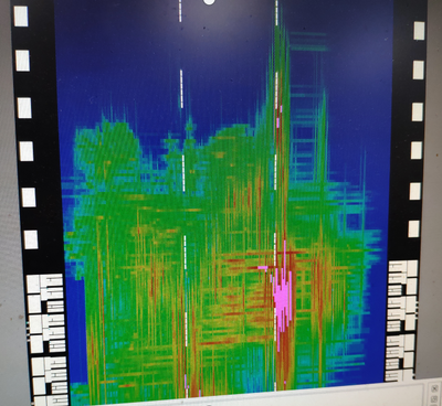

About the routing hotspots different from quartus 16.0.2 to quartus 18.0.0

Hi RichardTanSY,
I have not installed V21.3 and If I want, I need to apply for this, it's not convenient.
And I can provide additional information, one project like the above which use more less resource and its routing hotspots got from V17.1 is like to V18.0, so I inferred that the strategy is changed from V17.
Brs,
Lambert

Hi Richard,
I'm so sorry that I have no authority to share the RTL code to you.
And I can only tell you some information about this project:
first resource (based on 10ax115)
ALM : 21%; Total register : 125543; Total block memory bits 1%; HSSI RX channel 8/48 (17%); Total HSSI TX Channel 4/48 (8%); Total PLLs 57/112 (51%).
For transceiver : 4 Simplex RX IP (each have 4 channel); 2 Simplex TX IP (each have 2 channel). And all IP all located in different banks.
Second,I think you could use one bigger project like above and maybe the result as the picture which I show above, thanks.
Brs,Lambert
