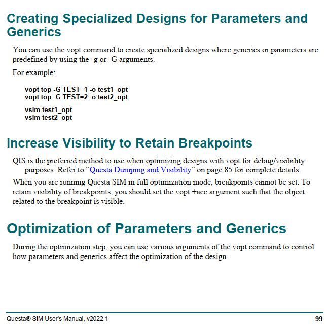

I have trouble using Questa-Intel with the Starter Edition License :
I have generic values in my top level which are set through the vsim command.
Example : vsim -gGENERIC_VAL=16 .....
It seems that the value defined with the "-g" argument is not propagated to my simulated design.
Is it a known limitation using the Starter Edition or am I missing something here ?
Thank you in advance.
thab
  • I think you need to use the vopt command instead of vsim.
    Reference: Questa Sim User Manual page v2022.1, page 99
