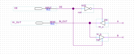

I have problems using a bidirectional pin in the cyclone 10LP custom board (10CL006YU256A7G).
I am using a bdf project, here is the implementation of the bidirectional pin:
on my ...

4 years agoHello bidirectional pin can be set at pin planner.
You dont need to do the bdf circuit like you showed.
