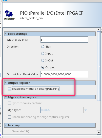

- tehjingy_Altera
Hi
To enable bit wise operation, you will need to enable "individual bit clearing/setting" settings in the PIO IP.
This will only affect the edge register. With this setting enabled, setting will only affect the bit instead of the entire register.
Jingyang, Teh

- BeB
Sorry for the late reply.
Your suggestion concerns the pio output register, which was not really the matter.
I am trying to understand why the complete variable 'edge_capture_ptr' should be overwritten when reading the edge capture register, and whether information from previous interrupts may be lost because of that.
Thank you!
Bertrand

- tehjingy_Altera
Hi
The implementation is the same for the edge register.
It is the ease of usage that we are setting the whole register, but underneath the API it is setting the individual bits instead of the whole register.
https://www.intel.com/content/www/us/en/docs/programmable/683130/24-3/edgecapture-register.html
Jingyang, Teh
