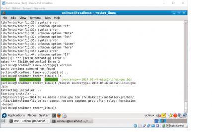

    i was succesful only in few points, i downloaded from git reporitory sopc2dts and make sopc2dts.jar, which can convert sopcinfo to dts. I create directory /home/rocket_linux and create and downloaded /buildroot, /linux-socfpga and sourcery binary codebench lite 2014.05-17 and when i try to install, it finished with permission denied ... in picture. How continue ?
    I try in make nios2_defconfig in buildroot directory, make 3c120_defconfig in directory linux-socfpga and everything finished with error. Is somewhere described more details, how to setting the linux machine ? (i use linux, which i used for building uclinux for nios2 2-4 year ago...
    Honza

    Sorry, your JPEG veiw is too small and indistinct, so I can't read the error message.
    Kazu

    it is strange, i included png about 99kB.
    So i wrote:
    $ /bin/sh sourgeryg++-2014.05-47-nios2-linux-gnu.bin
    Extracting installer ...
    Starting installer ...
    /tmp/sourgeryg++-2014.05-47-nios2-linux-gnu.bin_sfx.8a451e21/installer/jre/bin.
    ./lib/i386/client/libjvm.so: cannot restore segment prot after reloc: Permission denied.
    It was all ... how solve this error ? (i am not linux specialist)
    Thank you.
    --- Quote End ---
    Are you using SELinux? If so, please refer to the next pages
    http://www.cubrid.org/wiki_tutorials/entry/cannot-restore-segment-prot-after-reloc-permission-denied
    http://stackoverflow.com/questions/19223963/selinux-cannot-restore-segment-prot-after-reloc-permission-denied
    ... and so on.
