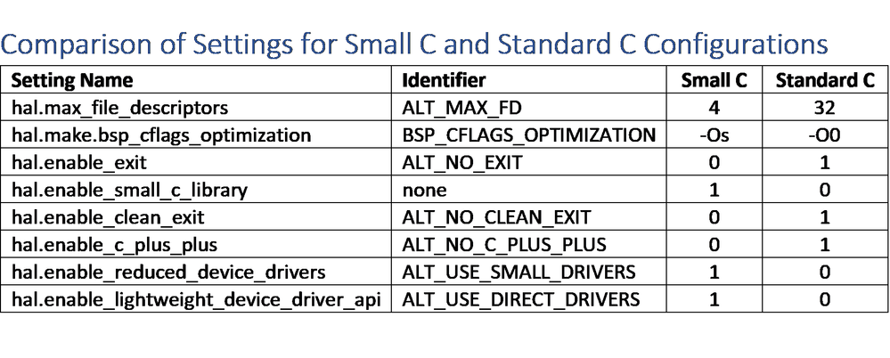

I'm using the NIOS 2/f in both configurations. Actually, it's exactly the same .qsys and .sopcinfo in both configurations because I have two software projects in the Eclipse software sub folder.
I used WinMerge to compare the two settings.bsp XML files. Here's what I found:
For the last column, I modified the standard BSP setttings to make them the same as the small BSP settings as a control test. Considering that there is a 5x speed difference, more is going on than I am aware of.

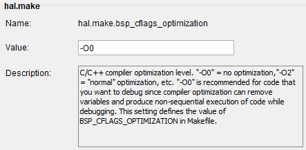

The description in the BSP Editor doesn't fully describe what the options mean, e.g. no mention of -Os.
I tried searching the PDF you linked to for the above settings and identifiers, e.g. BSP_CFLAGS_OPTIMIZATION and -O2 but nothing pertinent showed up.
Do you know where I can find detailed descriptions of the above parameters?

-Os: This is the most important compiler switch when optimizing for space. This instructs compiler to optimize for space rather than speed
Please refer below link
https://www.intel.com/content/www/us/en/programmable/documentation/lro1419794938488.html
