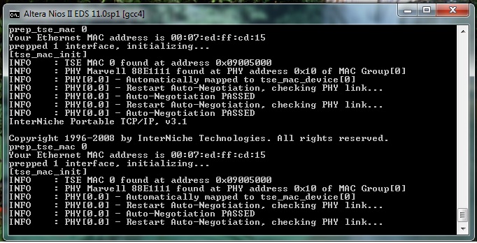

Hello i have a DE2-115 and i am using Q2 11.0SP1.
I used the web server reference design and trying to make a simple socket server work but it doesnt. I commented the led_pio thing. i changed the defines from EXT_FLASH to CFI_FLASH But it keeps restarting... Q11.1 doesnt seem quite ready for the market tbh..2 Replies

The same thing works on Quartus 10.1sp1

Got the same thing when I remove or rename some component in Qsys.
