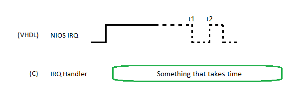

I'm now working on a NIOS II project and something about NIOS Irq bothers me.
Just as the image shows, my questions are :
- How long should we keep the irq line high?
- Will irq handler quit if we let down the irq signal in the middle?(like t1)
- What would happen at t2?
I'm not sure if my question is clear enough. Tell me if you need further information.
Thanks a lot.

- Ahmed_H_Intel1
Please check this document for better understanding of the IRQ with NIOS II
https://www.intel.com/content/dam/altera-www/global/ja_JP/pdfs/literature/hb/nios2/n2sw_nii52006.pdf
Regards.
