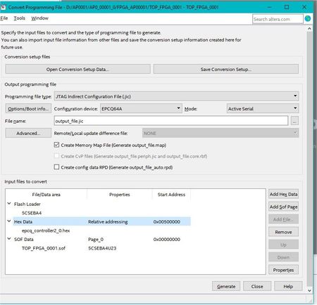

Hello to everyone ! I have my hardware with Cyclone V 5CSEBA4 , Quartus 18.1 standard licensed. I make a QSYS with an EPCQ64 controller and NiosIIF and I develop my application with Eclipse. It ru...

7 years agoThere is anyone about this issue? I cannot believe that there isnt' anyone that have a Cyclone V + niosII processor HW to run! Or this problem afflicts only our system? Passing from Altera to Intel causes many link mismatch and many problems :-(
